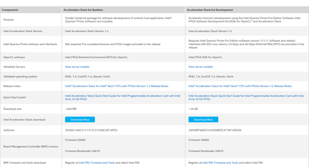

7 years agoI am having the same issue in OpenVINO 2019R1. classification_sample but classification_sample -d HETERO:FPGA,CPU does not.
And I install dev not rte,the right one. so I don't have /opt/altera/aocl-pro-rte/aclrte-linux64 link:https://software.intel.com/en-us/forums/computer-vision/topic/808441#comment-1940333 ...

jjunn
7 years agoThe aocx file that I used is 2019R1_RC_FP11_ResNet_SqueezeNet_VGG.aocx . I followed the step ,and I am running in root. The problem is the guide providing a runtime version. And I install the dev version in the right of the picture.
guide:https://docs.openvinotoolkit.org/latest/_docs_install_guides_PAC_Configure_2019R1.html
