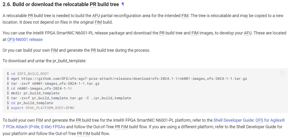

So I went through the document again and found out about Relocatable PR Directory. And I thought this is used to create a project which can be used to compile within quartus. So I tried running this and got it to work successfully, but I think I must've misunderstood what this means since it doesn't generate a Complete Quartus project file with every file present within the Quartus Project, but generates some files and binaries. What exactly is this feature used for?
Is there any way after building the Quartus project in the Linux environment, after which I can copy the project file and then continue designing in a Windows environment without having to run scripts and just use Quartus to do everything?

    For the PR directory, its mainly used to share your FIM settings with others who wants to do their own AFU configuration, but it still needs to be executed via script
    eg. if user just want to use the default fim, he/she will just download the prebuilt FIM from here and run their own AFU from there. It looks like still need to run through script though.
    Reference:
    https://ofs.github.io/latest/hw/common/user_guides/afu_dev/ug_dev_afu_ofs_agx7_pcie_attach/ug_dev_afu_ofs_agx7_pcie_attach/#26-build-or-download-the-relocatable-pr-build-tree
    https://ofs.github.io/ofs-2024.1-1/hw/n6001/dev_guides/fim_dev/ug_dev_fim_ofs_n6001/#223-out-of-tree-pr-fim

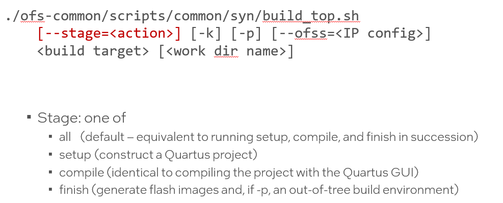

    Just to follow up on this , our OFS team mentioned that there is one additional parameter ( --stage) in command that should generate out the Quartus project that can compile, but the command seems to be like for internal usage as it is not published out externally in documentation.
    First you will need to use the public repo, not the one in github.com/otcshare i suppose , as the example given is based on public repository build script, not the otcshare build script command.
    Example using this
    https://github.com/OFS/ofs-agx7-pcie-attach (formerly known as https://github.com/OFS/ofs-n6001)
    eg .
    git clone --recurse-submodules https://github.com/OFS/ofs-n6001
    export OFS_ROOTDIR=${PWD}/ofs-n6001
    export WORKDIR=${OFS_ROOTDIR}
    build command with the --stage option
    Could you try using the command below with --stage compile, that should give you a quartus project that you can compile in GUI
    In $OFS_ROOTDIR
    ./ofs-common/scripts/common/syn/build_top.sh --stage compile n6001 work
    In project directory inside work tree:
    quartus_sh --flow compile ofs_top –c ofs_top
    Or:
    quartus ofs_top –c ofs_top <-- Use the GUI
    Kian
