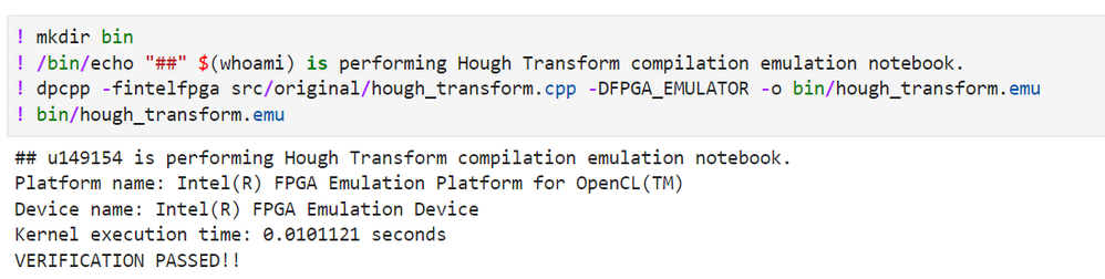

- DeepikaGanga
Thank you , that seems to have worked, here is the PASS status after adding the mkdir bin command.
