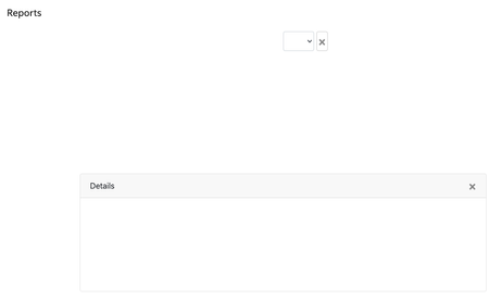

FPGA "Getting Started" report broken
It's definitely not server or browser-configuration related.
It's do to with the early-link report automatically including the source code of every file used by the build in the `fileJSON` variable in `report_data.json`. In fact, specifically, in the machine I'm using it's `/opt/intel/oneapi/compiler/2021.3.0/linux/include/sycl/CL/sycl/detail/os_util.hpp`, which has on line 71:
