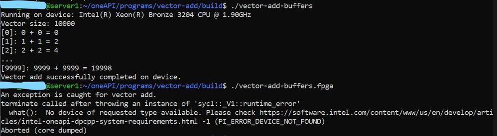

Fpga device not found on oneAPI
I recently installed oneAPI. I have an fpga connected to my device however when i compile and try to run on the fpga, i cannot find the device on oneapi.
Fpga used is Arria10.
8 Replies
  • aikeu's avatar
    aikeu
    Hi Chithambarash,
    Can you show me the related environment interface or error which you have encounter?

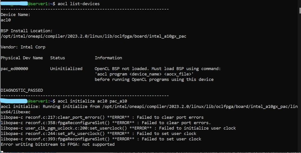

    Hi Chithambarash,
    Can double check if you are using the correct board variant "pac_a10" in your input command?
    aocl initialize <board id> <board variant>
