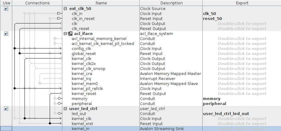

I'm using a Terasic DE10 Standard board, below you'll find the modified board_spec.xml and Qsys System:

  <!-- Modification: Adding channels -->
  <channels>
    <interface name="user_led_ctrl" port="kernel_in" type="streamsink" width="8" chan_id="ch_user_led_ctrl"/>
  </channels>
</board>
