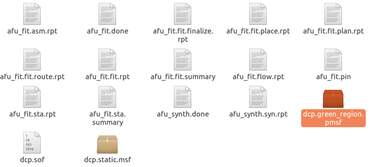

      There is a .pmsf file in the output files folder but name isn't the same as the mentioned afu_fit.green_region.pmsf. It is called dcp.green_region.pmsf
