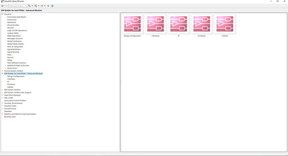

I'm first time use the DSP builder. I have installed Quartus Prime Pro 20.1 and MATLAB2020b.
I can launch DSP Builder and start Simulink. There are DSP Builder for Intel FPGAs - Advanced Blockset and directories under it, e.g. Interface, IP, etc. see blow.
However there is nothing under them.
What should be done then. Thank you.

Intel Quartus Prime Pro Edition supports the following Mathworks Matlab. Could you please try to install a compatible version?
2017b. 2018a, 2018b, 2019a, 2019b.
The DSP builder Advance blocks come with a lot of example designs that may help you. Please find those designs from the link below.
"installation path"\quartus\dspba\Examples
