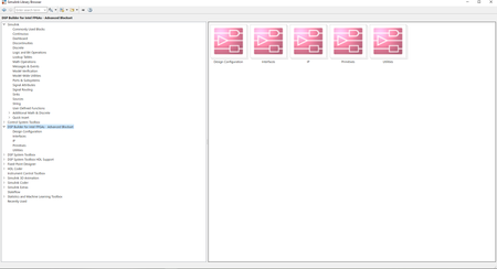

I'm first time use the DSP builder. I have installed Quartus Prime Pro 20.1 and MATLAB2020b.
I can launch DSP Builder and start Simulink. There are DSP Builder for Intel FPGAs - Advanced Blockset ...

Intel Quartus Prime Pro Edition supports the following Mathworks Matlab. Could you please try to install a compatible version?
2017b. 2018a, 2018b, 2019a, 2019b.
The DSP builder Advance blocks come with a lot of example designs that may help you. Please find those designs from the link below.
"installation path"\quartus\dspba\Examples
