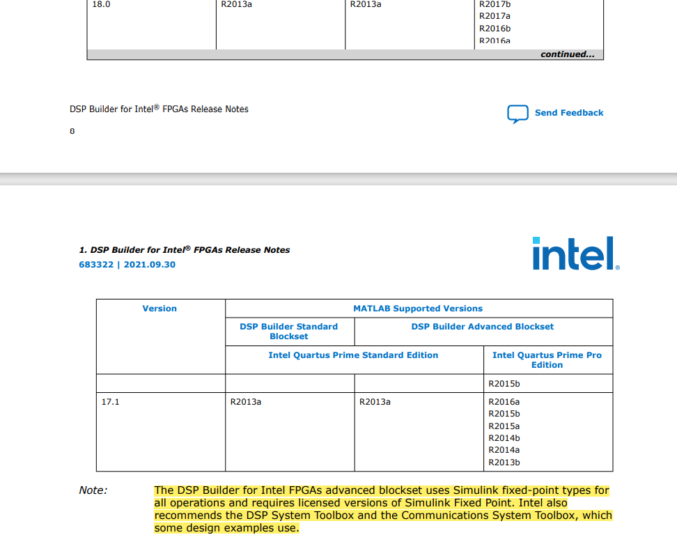

DSP Builder for Intel FPGAs advanced blockset
IN DSP Builder for Intel® FPGAs Release Notes 21.3 they have mentioned one note
Note: The DSP Builder for Intel FPGAs advanced blockset uses Simulink fixed-point types for all operations and requires licensed versions of Simulink Fixed Point. Intel also recommends the DSP System Toolbox and the Communications System Toolbox, which some design examples use.
Could you please someone explain this to me
1 Reply
  • Kshitij_Intel's avatar
    Kshitij_Intel
    It means when you buy MATLAB license, additionally you have to buy Simulink Fixed Point Library to use Intel FPGAs advanced blockset.
    And you may need to buy DSP system toolbox and Communication System Toolbox to run some design examples.
    Thank you
    Kshitij Goel
