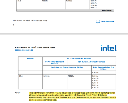

IN DSP Builder for Intel® FPGAs Release Notes 21.3 they have mentioned one note
Note: The DSP Builder for Intel FPGAs advanced blockset uses Simulink fixed-point types for all operations an...
Kshitij_Intel
4 years agoHi,
It means when you buy MATLAB license, additionally you have to buy Simulink Fixed Point Library to use Intel FPGAs advanced blockset.
And you may need to buy DSP system toolbox and Communication System Toolbox to run some design examples.
Thank you
