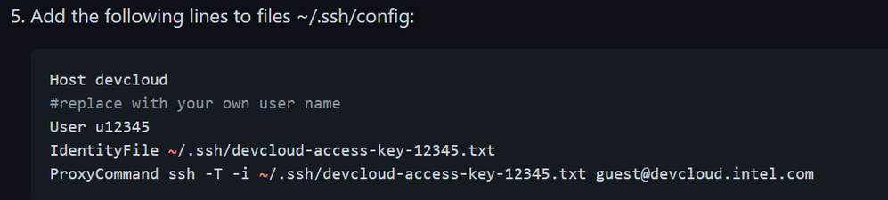

I've completed every step until section "3.3 - Downloading a SSH key". I can't execute the commands on instruction 5:
Instruction 5 on section "3.3 - Downloading an SSH key"
If I try the command "Host devcloud", mobaterm shows the error "Host: command not found". I didn't create a file called "config", and neither can I find a directory on my PC.
Could you please help me?
Thank you a lot!
  • You should first create a folder named ".ssh" in your "home" directory, then create a file named "config" inside that folder, and then add those lines inside that file.
  • HRZ's avatar
    HRZ
    • ydaglian's avatar
      ydaglian
      Thank you, that was it!
      I had to learn a little bit of Linux terminal commands to do it, but your answer helped me to know what to search for!
      I believe the commands should be stated in the DevCloud tutorial. It could help other users.
