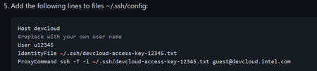

Hi all,
First of all, thanks for helping me. I'm an Intel employee in Intel Brazil and I'm trying to use the FPGA DevCloud.
After following the instructions on github, I'm stuck and need help t...

You should first create a folder named ".ssh" in your "home" directory, then create a file named "config" inside that folder, and then add those lines inside that file.

5 years agoYou should first create a folder named ".ssh" in your "home" directory, then create a file named "config" inside that folder, and then add those lines inside that file.
ydaglian
5 years agoThank you, that was it!
I had to learn a little bit of Linux terminal commands to do it, but your answer helped me to know what to search for!
I believe the commands should be stated in the DevCloud tutorial. It could help other users.
