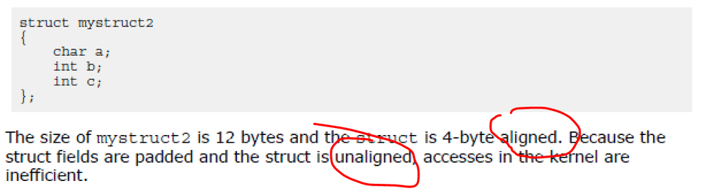

1) For mystruct2, it is first said that the struct is 4-byte aligned, and then it is said the struct is not align in the following sentence. What does it mean ?

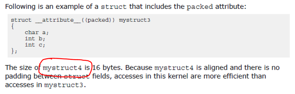

2) There is no mystruct4 in the figure

For your first question, we will need time to look into this. The explanation might be not clear enough.
For your second question, we will fixed documentation as the mentioned above.
- MEIYAN_L_Intel
I had review the document and there is a mistake in the document. With the extra padding, the struct is aligned.
