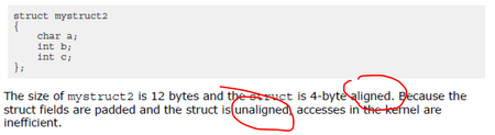

7 years agoConfusing descriptions in the OpenCL Best Practice Manual on data alignment
Section 3.5 of the Best Practice manual: 1) For mystruct2, it is first said that the struct is 4-byte aligned, and then it is said the struct is not align in the following sentence. What does it mea...

I had review the document and there is a mistake in the document. With the extra padding, the struct is aligned.
