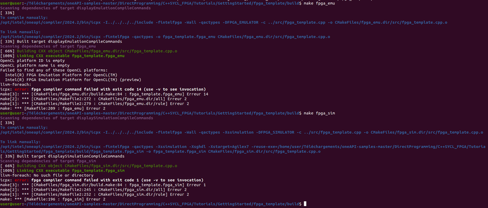

I just updated my version of oneAPI to 2024.2 with the Base Toolkit and I don't know if I'm the only one but even after downloading the FPGA Support Package I can't compile my code anymore for emulation and for simulation. Do you have a solution or should I rollback to oneAPI 2024.1 ? Thank you !

      Hi @Kevin_Xu_Intel,
      I just downloaded the example from github and here is the error that I have when I try to compile the code for emulation and for simulation :
      Do you have an idea of what could be the issue ? Thank you !

  • Hi DorianL,
    It looks like there might be an installation problem. I just have a few questions to help us debug your install:
    1. What OS are you installing on?
    2. Can you show us your environment setup? (Can i see the output of "printenv"?)
    3. I want to double check if the FPGA compiler is working, can you try "aocl -diagnose"?
    -Kevin

      3. The command "aocl -diagnose" is not found on my system even after loading the oneAPI environment variables. Does it means that I don't have the FPGA compiler ?
      Thank you !
      DorianL
  • Hi DorianL,
    I found someone who encountered the same error:
    OpenCL platform ID is empty
    OpenCL platform name is empty
    Failed to find any of these OpenCL platforms:
    Intel(R) FPGA Emulation Platform for OpenCL(TM)
    Intel(R) FPGA Emulation Platform for OpenCL(TM) (preview)
    You might want to try reinstall the oneAPI base toolkit and FPGA support package according to this guide:
    https://www.intel.com/content/www/us/en/docs/oneapi/installation-guide-linux/2024-2/install-compiler-components-for-altera-fpga.html
    -Kevin

      Hi @Kevin_Xu_Intel,
      Thank you for your help ! It is now working with the installation guide that you gave me. You can close the topic now.
