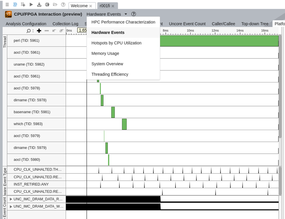

This is what I got:

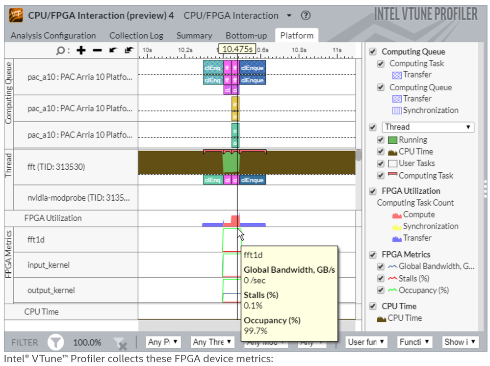

This is what is shown in the online document https://software.intel.com/content/www/us/en/develop/documentation/vtune-help/top/analyze-performance/platform-analysis-group/cpu-fpga-interaction-analysis-preview.html
As compared above, there is no CPU/FPGA interaction tab in my tool. How could I get it displayed ?
