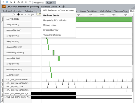

Hi, I am using Vtune profiler v2020 update 1 with Intel FPGA OpenCL SDK v20.1, and I am trying to read the profiled data with vtune. However, I could not get the CPU/FPGA interaction tab as described...

DongWang-BJTU
6 years agoHi, the problem has been solved with the help of an AE.
One need to run the "aocl profile ./youhost -x yourKernel.aocx" command to manually generate the profile.json file before using the Vtune gui. Otherwise, vtune will not work correctly.
This information was not described in the user manual.
