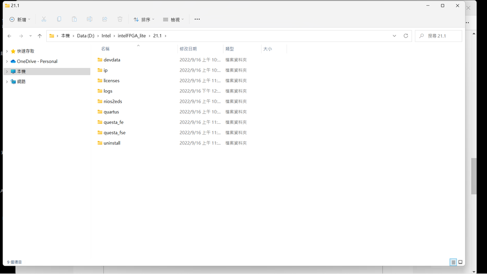

  • Raphaier's avatar
    Raphaier
    Hi ,
    Below attached is currently I have file, could you specific tell me the directory? Thanks.
