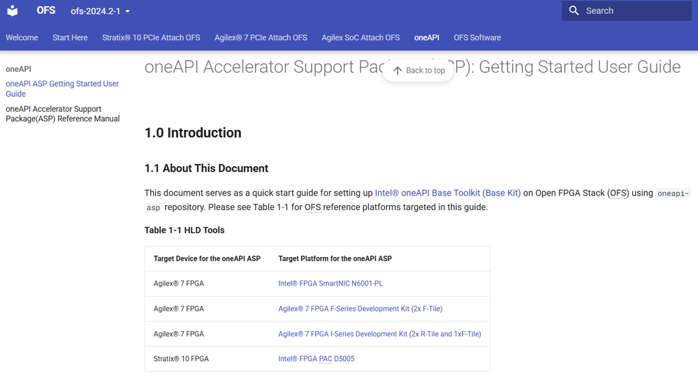

On the getting started page of the OFS website, the link to Stratix 10 shows:
| Stratix® 10 FPGA | Intel® FPGA PAC D5005 |
Since the DE10-pro board is also a "Stratix® 10 PCIe Attach OFS", I was wondering if I could follow this guide to build BSP for this board.
Thank you
5 Replies
- JSYOO
I meant to add this OFS website screenshot

Unfortunately for the mention of following the guide of Stratix® 10 PCIe Attach OFS, it may work as there are different in term of hardware/software/interconnect/memory. And the BSP are not for DE10-pro.
Also as of current date, there are no guide with BSP for DE10-pro.
However as the board are from Terasic, would recommend to get in touch with Terasic support as they may have more details on the BSP required.
Hope that clarify.
