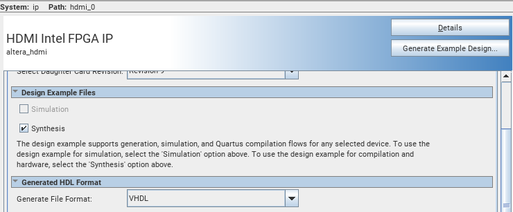

Due to a problem in the Intel® Quartus® Prime Pro Edition Software version 23.2, you may see the following error when compiling VHDL variants of the HDMI Intel® FPGA IP Design Example:
Error(13879): VHDL Binding Indication error at hdmi_rx_ram_1port_intel_mce_2010_tnbtyoy.vhd(59): generic "node_name" in design entity does not have string type that is specified for the same generic in the associated component.
