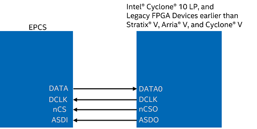

Figure 1.  Pin connections between EPCS devices and Intel® Cyclone® 10 LP FPGAs and Legacy devices earlier than Stratix® V, Arria® V, and Cyclone® V  FPGAs for 1-bit data width Active Serial configuration mode.

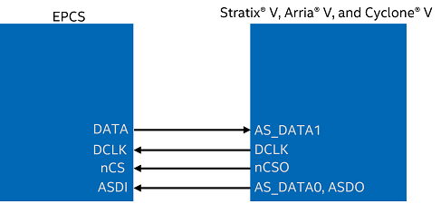

Figure 3. Pin connections between EPCS devices and Stratix® V, Arria® V, and Cyclone® V FPGAs for 1-bit data width Active Serial configuration mode.
