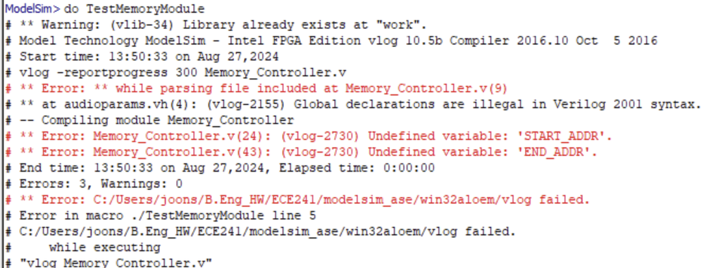

When I attempt to run the TCL script above to generate a ModelSim simulation, I get these errors:
I am wondering why the terminal thinks that START_ADDR and END_ADDR are undefined variables even though the parameters are imported into this verilog file. I was also wondering if perhaps, only the top level module (i.e. Memory_Controller.v) is being compiled, instead of all the files in the project?

    you quoted the relevant error message in question title "no global parameters in Verilog". Seeing this error, why do you wonder about follow-ups? You can select SystemVerilog syntax for the respective modules, or use defined macros instead of parameters. Quartus apparently doesn't distinguish different Verilog revisions so strictly, or did you globally enable SV syntax in Quartus?
