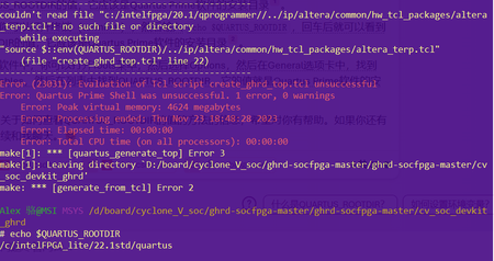

2 years agoWindows GHRD for cycloneVsoc make failed
Hi Under SOCEDS v20.1 and Quartus Prime lite 22.1std using MSYS2 running make generate_from_tcl failed duel to the QUARTUS_ROOTDIR error, following is the printscreen of the error: My variabl...

Hi CAlex,
To run make generate_from_tcl we will need to initiate the nios2_command_shell
Is ~/intelFPGA/22.1std/nios2eds/nios2_command_shell.sh \ working before you run the generate_from_tcl ?
Link before shows the steps in getting the ghrd and compile the ghrd using commands:
