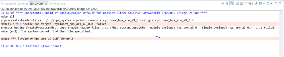

I downloaded the following project for Cyclone V SOC Development Kit:-
FPGA-to-HPS Bridge Design Example for CV SoC DevKit Rev E
and programmed the FPGA using .sof file on my kit which is done successfully.
However, when I try to compile the software project in eclipse on my Windows 10 machine, it gives the following error attached in the image file.
Why is such error here? How do I remove this error?
- MHada
I am unable to find cycloneV_hps_arm_a9_0.h
Where can it be found? Please inform.
Also please let us know as to why this problem is coming?

Can you rebuild the project by following the steps below from page 26 to page 29:
https://www.intel.com/content/dam/www/programmable/us/en/pdfs/literature/ug/ug_soc_eds.pdf#page=26
- EBERLAZARE_I_Intel
Have you try rebuilding the project following the steps above?
I did face the similar error when using a prebuilt project, thus I attempt to rebuild the project and it does removes the error.
