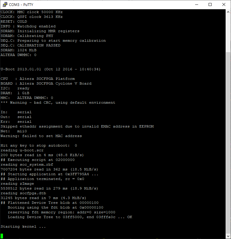

The error log from the serial terminal is as follows:
It seems that the above log doesn't contain enough information.
So my question is...
1) If this situation is quite common, is there any suggestion to properly boot the device?
2) How can I debug this error, with a detailed error log?

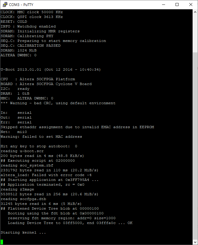

Hello Aik, thank you for your prompt reply.
I've replaced soc_system.rbf file with the default GSRD file with the latest version but still got the same message.
(In addition, altera_load function fails!)
I'll try to make a new booting disk using the past releases (u-boot-cyclone5.img) and let you know about the results.

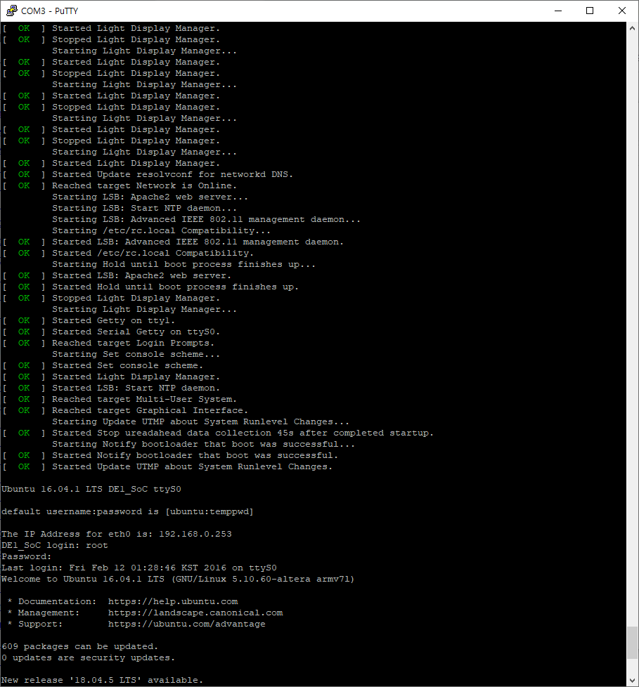

After replacing zImage file rather than .rbf file, I could successfully boot the device
(It might be obvious since .rbf file only contains the FPGA programming data and zImage contains Linux kernel data...)
Thank you for your suggestion!
