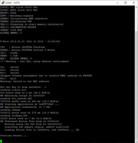

4 years agoU-Boot Failure on DE1-SoC Board, stopping at "Starting kernel ..."
I'm wondering if this question fits into this thread.
I'm trying to use lubuntu OS at DE1-SoC board, through HPS.
I was well using the device for a few months, but recently I cannot boot...
- 4 years ago
Hi 서박사,
I think high chance that your Linux kernel files are corrupted. Can you try to use back the default GSRD files to try boot up your Linux kernel again?
Link to the GSRD release files: https://releases.rocketboards.org/release/
Aik Eu
aikeu
4 years agoHi 서박사,
Aik Eu
서박사
4 years agoAfter replacing zImage file rather than .rbf file, I could successfully boot the device
(It might be obvious since .rbf file only contains the FPGA programming data and zImage contains Linux kernel data...)
Thank you for your suggestion!
