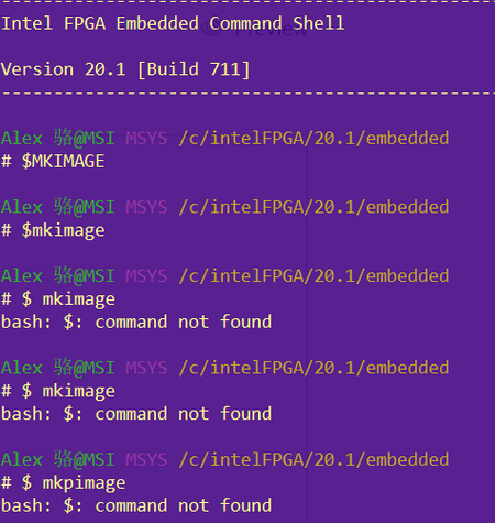

2 years agoSOCEDS 20.1 stanard mkimage tool not found
Hi, but I found mkpimage,are they alike? But still, I can't use mkpimage under shell. Reguards Alex

Regarding your question on mkimage vs mkpimage
Note: there is a downloadable link for prebuild mkimage utility in the u-boot image tool mkimage that you might be able to use
https://www.intel.com/content/www/us/en/docs/programmable/683187/20-1/u-boot-image-tool-mkimage.html
Do note that SOC EDS been discontinued and new Quartus actually have a new build flow for the bootloader in RocketBoards
https://www.rocketboards.org/foswiki/Main/GettingStarted

1 year agoIt is solved, thank you
