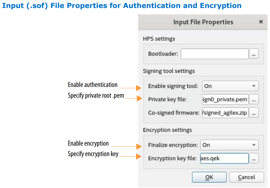

For the Stratix 10, I see there is an encryption feature where the SDM decrypts the bitstream. Is there any possibility of using the SDM to support an encrypted FSBL? I’m basically interested in encrypting the bootloader software, not just the FPGA bitstream.

    When we enabling bitstream encryption on HPS FSBL (included the hex file in the PFG tool), FSBL will be encrypted as well.
    Sorry for the confusion.

      Related to the FSBL part, just to make sure I understand your answer, does it mean that enabling "bitstream encryption" on -AS devices does not result in the FSBL being encrypted?
      By FSBL, I'm refering to the ".hex" file content specified using "-o hps_path" with quartus_pfg -- the first code executed by the HPS.

    Sorry, I'm really having trouble accepting this answer and meant to reply earlier... Are you suggesting that the FSBL is not part of the bitstream? This seems highly counterintuitive given the way the Quartus tooling is used...

    Apologies for the delay. I was consulting with the internal team to get clarification on this matter.
