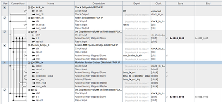

Hi, all! I'm currently learning how to implement data transfer using mSGDMA and have created a Qsys project for simulation verification. However, the simulation results show that the mSGDMA isn't fu...
