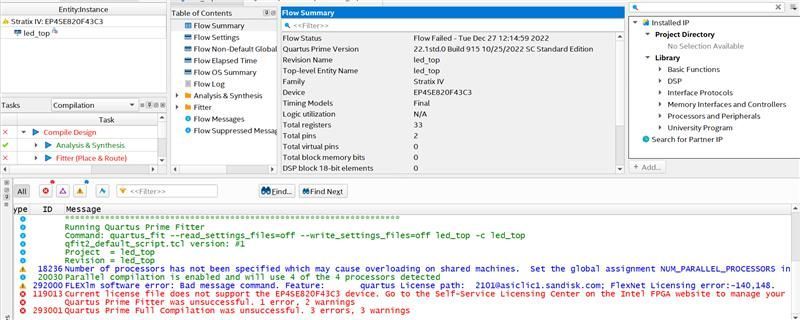

we have tried to map license key with the quartus 22.1 version in windows 10 . we are facing below errors ""Error (119013): Current license file does not support the EP4SE820F43C3 device ,Go to the Self-Service Licensing Center on the Intel FPGA website to manage your licenses" But the same key is working for Quartus 17.1 version on linux. We need support to fix this issue.
please find below attachment regarding it .

Welcome to INTEL forum. Could you help to upgrade the Flexlm License Daemons for Intel software to the newer version and try it.
https://www.intel.com/content/www/us/en/software-kit/709649/license-daemon.html
Let us know how it goes.
