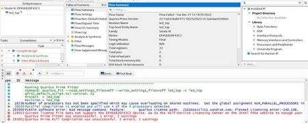

we have tried to map license key with the quartus 22.1 version in windows 10 . we are facing below errors ""Error (119013): Current license file does not support the EP4SE820F43C3 device ,Go to...

Welcome to INTEL forum. Could you help to upgrade the Flexlm License Daemons for Intel software to the newer version and try it.
https://www.intel.com/content/www/us/en/software-kit/709649/license-daemon.html
Let us know how it goes.
