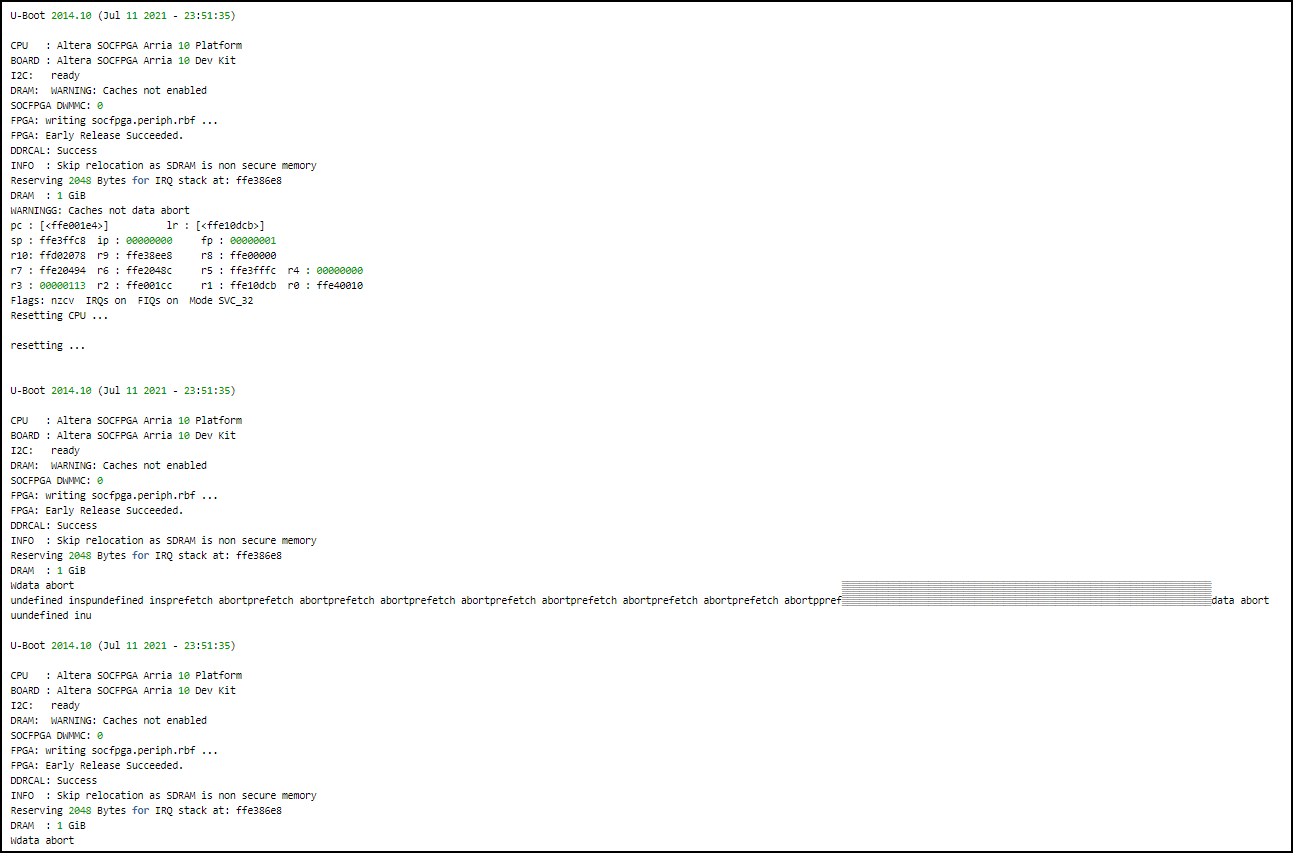

Not able to boot newer Arria 10 SoC boards
Hi Team,
I have custom linux image that works fine and am able to boot the older Arria10 SoC Development kits. But, with the same linux image, the newer Arria10 SoC board is not booting. Why is it happening so? Is there any difference between older and newer Arria10 SoC boards? I have attached the boot log as well.

    I am sorry for late reply. You need to check the devkit serial number as there are different revisions built for Arria 10 devkits.
    If the OPN is different, then you need to rebuild the linux image.
