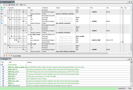

Hi everyone
I'm working on a Terasic balance_car project in the DE10-NANO board by using Nios2.first of all, I using the BAL_CAR_Nios_Code project's demo code of Terasic, also add the EPCS Flash co...
- 5 years ago
Finally, I fixed the problem by delete all data in the Eclipse IDE workspace and create a new project again.
I figure the matter is my .sof version doesn't match .elf, so rebuild it can fix it.

ScottShin
5 years agoThis was my question that about the program to EPCS64 by .jic.
