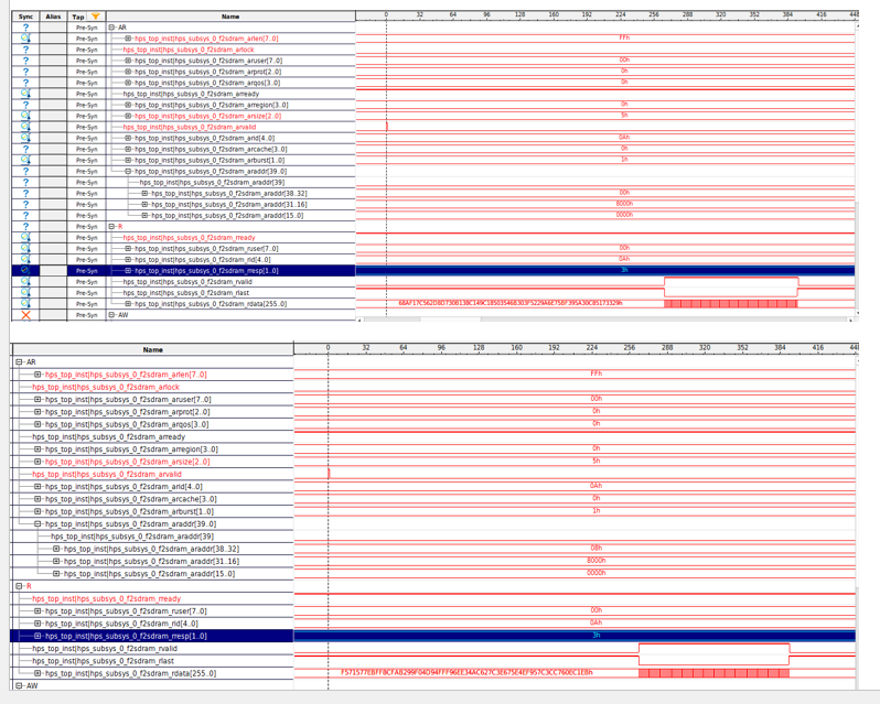

- aucamera16 months ago
Hi Yoda_Altera
Hi Yoda,
Attached are the Read signals from a read cycle to the SDAM. Here I’m showing 00_8000_0000 and 08_8000_0000 address, but the “9” addresses behave the same
thanks
