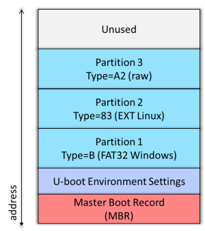

Yes I am booting from the SD card using the preloader, that loads u-boot, and then it loads the bare metal C program to the HPS, and the .rbf code to program the FPGA as well.
Here is the SD Layout I am using
- Ahmed_H_Intel1
Hi, The following document has a useful info for you, please check: https://www.intel.com/content/dam/www/programmable/us/en/pdfs/literature/ug/ug_bm.pdf
