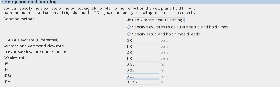

Im working on a cyclone V device with DDR3 MICRON vendor.
we are now trying to fill up the board parameters in the setup and hold derating section.

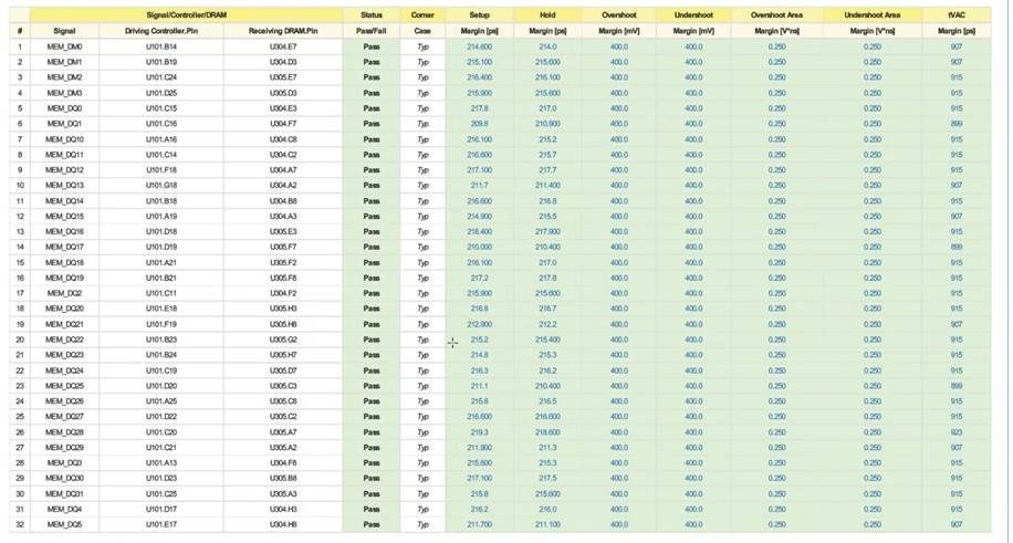

we have some board simulation data from the board designer layout but we don't sure what value to take.
The tis,tih,tds,tdh in the simulation output are margin from the minimum setup and hold.
Do we need to add this margin value to ddr spec tis and tih ?
tis,tih:
tds,tdh:
thanks for your answer in advance,
BR,
Ram.
