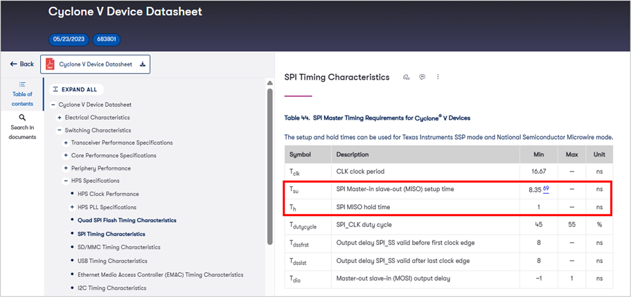

The Cyclone V Device Datasheet and the Hard Processor System Technical Reference Manual do not contain a formula for determining Tsu (min) from rx_sample_dly and spi_m_clk.
In the datasheet, Tsu = 8.35 ns (min) is only shown as a characteristic value under the condition "rx_sample_dly = 1, spi_m_clk = 120 MHz" (Note 69).
Also, Th = 1 ns (min) has no note indicating its relationship with rx_sample_dly and spi_m_clk.
• [Reference] Cyclone V Device Datasheet → "SPI Timing Characteristics"

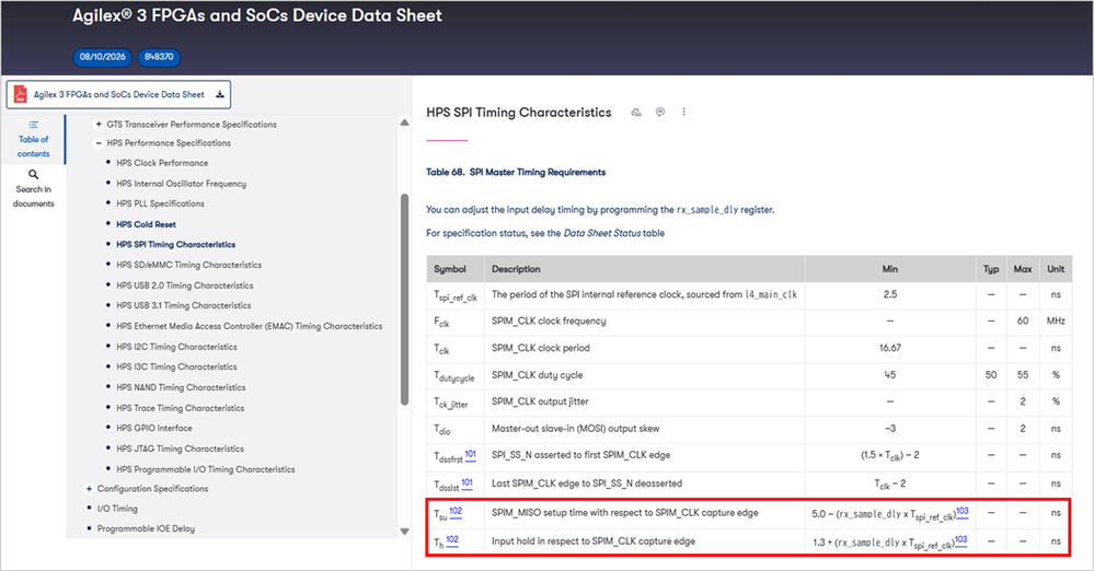

On the other hand, the datasheet for a newer generation device (such as the Agilex 3) equipped with the same SPI controller has the following expression:
• Tsu(min) = 5.0 − (rx_sample_dly × Tspi_ref_clk) [ns]
• Th(min) = 1.3 + (rx_sample_dly × Tspi_ref_clk) [ns]
• [Reference] Agilex 3 FPGAs and SoCs Device Data Sheet → "HPS SPI Timing Characteristics"

    Q1 & Q2 — Does the Cyclone V datasheet provide a Tsu/Th formula?
    No — the Cyclone V datasheet does not publish a general formula analogous to Agilex 3's expressions.
    Base on the foot note the operating point are (rx_sample_dly = 1, spi_m_clk = 120 MHz) for the Cyclone V.
    Q3 — Can the Agilex 3 formula be applied to Cyclone V?
    No - The formula used in the Agilex3 is not applicable to the Cyclone V. The formula is device specific.
