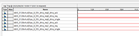

Cyclone V H2F DMA is dead
- 11 months ago
Solution:
modify the uboot repository with proper reset control for dma pl330.
Had patch and email to uboot for review.

What you image is kernel not U-Boot section.
The PL330 driver had nothing to do with the dts itself.
BTW the solution is working and you can check patch on Das U-Boot.
