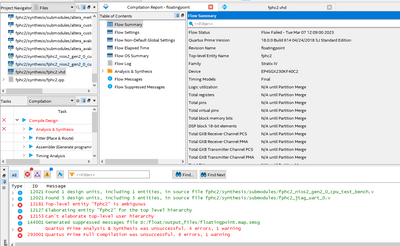

I want to do some calculations which involves floating point with nios ii. So I made qsys system adding floating point hardware 2 component then generated hdl. and add all files to quartus and tried ...

Firstly, remove the/all unnecessary files in the "Files" tab in Quartus after you generate HDL in Platform Designer.
Then locate the .qip files in the "synthesis" folder directory that you generated from Platform Designer above.
Add the .qip file in the "Files" tab. And compile your Quartus.

Can I get the design files from you and let me check from my side ? Also, which Quartus version and OS machine are you working on?

Sorry for the delay of my reply.I used windows ,quartus prime standard edition and my device is Stratix iv 230
Here I have attached the project. Please check
