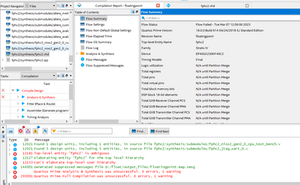

I want to do some calculations which involves floating point with nios ii. So I made qsys system adding floating point hardware 2 component then generated hdl. and add all files to quartus and tried ...

tel Sorry for the delay of my reply.I used windows ,quartus prime standard edition and my device is Stratix iv 230
Here I have attached the project. Please check
