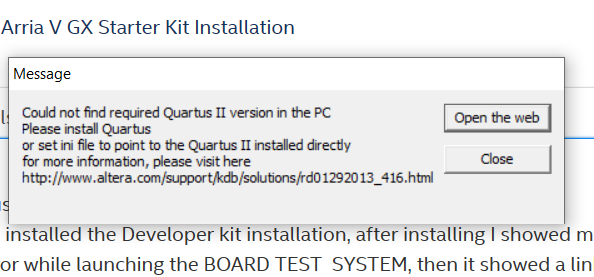

I have installed the Developer kit installation, after installing I showed me an error while launching the BOARD TEST SYSTEM, then it showed a link to solve the error by setting the environmental path, even after doing every thing I was not able to solve it.
so I was hoping I can get some help here

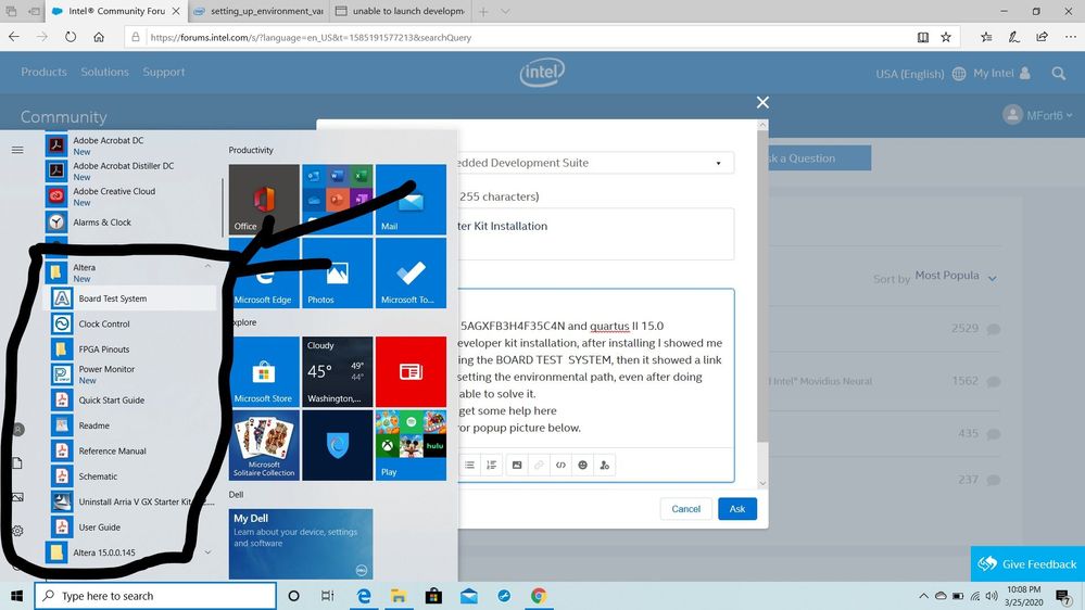

I am attaching the error popup picture below.

    Welcome to INTEL forum. Based on my understanding, possibly it is caused by the difference in system console of different Quartus revisions. The BTS module for Arria V GX Starter Kit is build based on Quartus® 12.1.0 build 177. It is suggested to use the right Quartus version with the right dev.kit version.
    You can refer to readme.txt file that accompanies the Starter Kit, Arria V GX Edition. https://www.intel.com/content/www/us/en/programmable/products/boards_and_kits/dev-kits/altera/kit-arria-v-starter.html

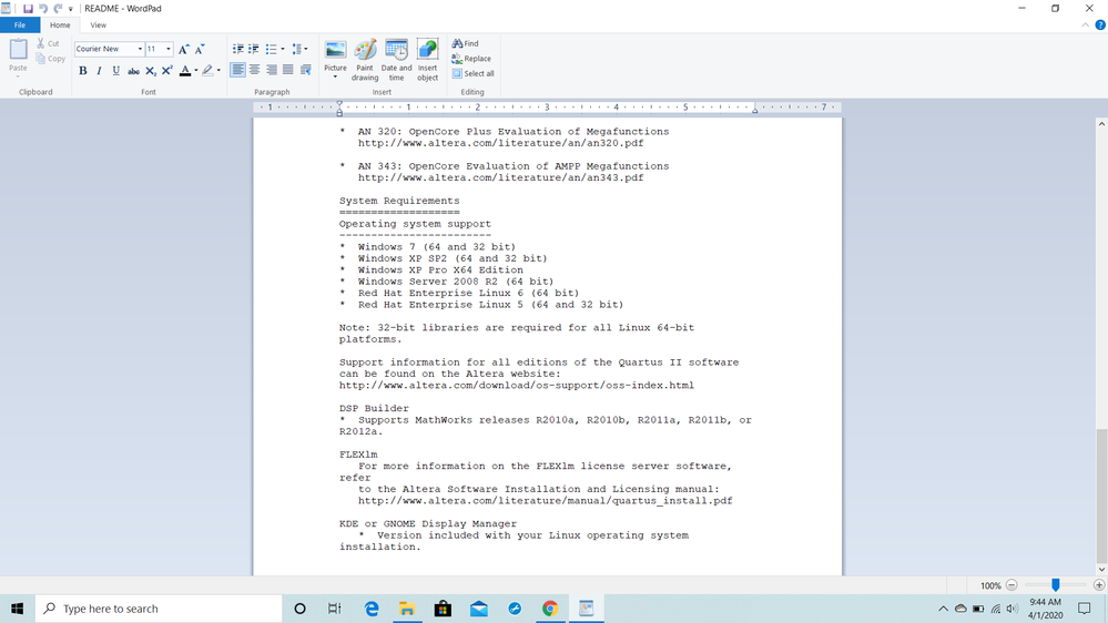

    in the read me text file it is written it can support upto W7

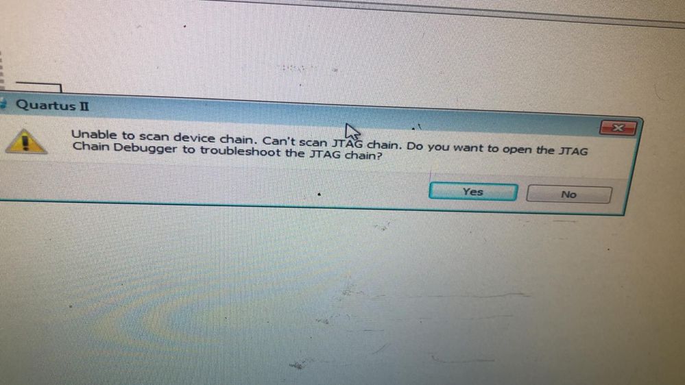

    I have solved the issue but i am face a problem in JTAG Chain
    when i try to rest the fpga for factory default i am unable to program it
    i am getting the following errors.
    i am unable to figure it out
    can you please help me with this error.

    Hi, could you try this? the default JTAG clock frequency for the USB-blaster is 24M. Could you try reducing the JTAG clock speed to 16M or 6M to see how things go.
