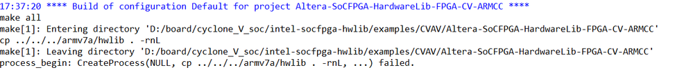

When using arm compiler 6 (built-in)/GCC(Linaro 7.5.0 for x86_64), the alt_bridge_f2s_armcc.s/gnu.s cant be compiled.
Do you know how to fix that?
I'm building the examples through ARM DS, but the examples can't build well. They are either cant cp the hwlib or cant compile the above source file.

Another error is like that:
I didnt change anything and did exact steps of readme.txt file said, I openned the ide through SOCEDS,reseted the QUARTUS_ROOT and clicked the build button.

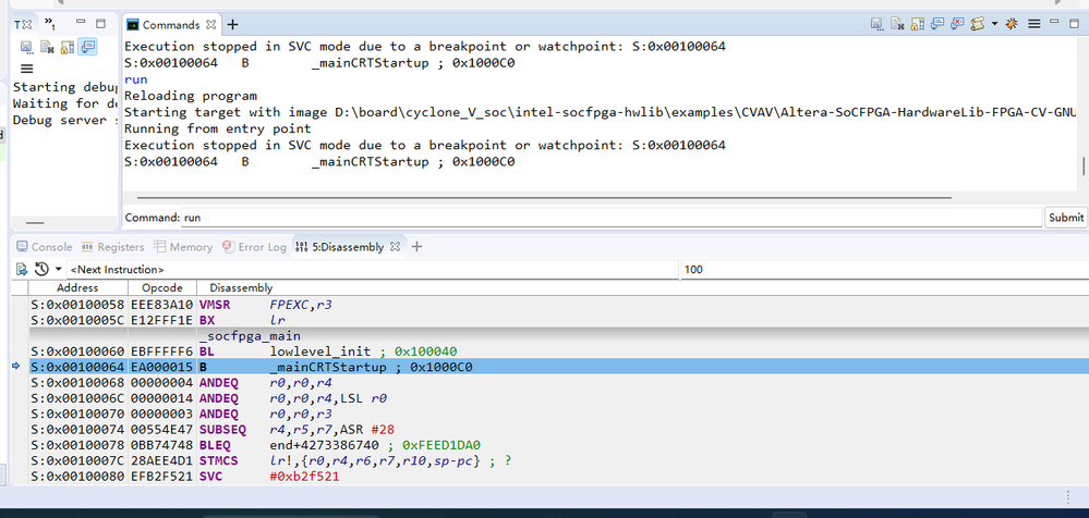

The other issue came to me :
When I ran the cycloneV FPGA GNU examples with ddr and semihosting the debug stopped at order line: B _mainCRTSartup:
I didnt set any breakpoint or watchpoint. The socfpga I used is coming from GHRD with noi change.
Reguards.
- CAlex
Contributor
When I restarted all the system it came to normal again.
Here is the solution from ARM experts:
You need to get into the breakpoint view to do some settings to avoid this issue.
