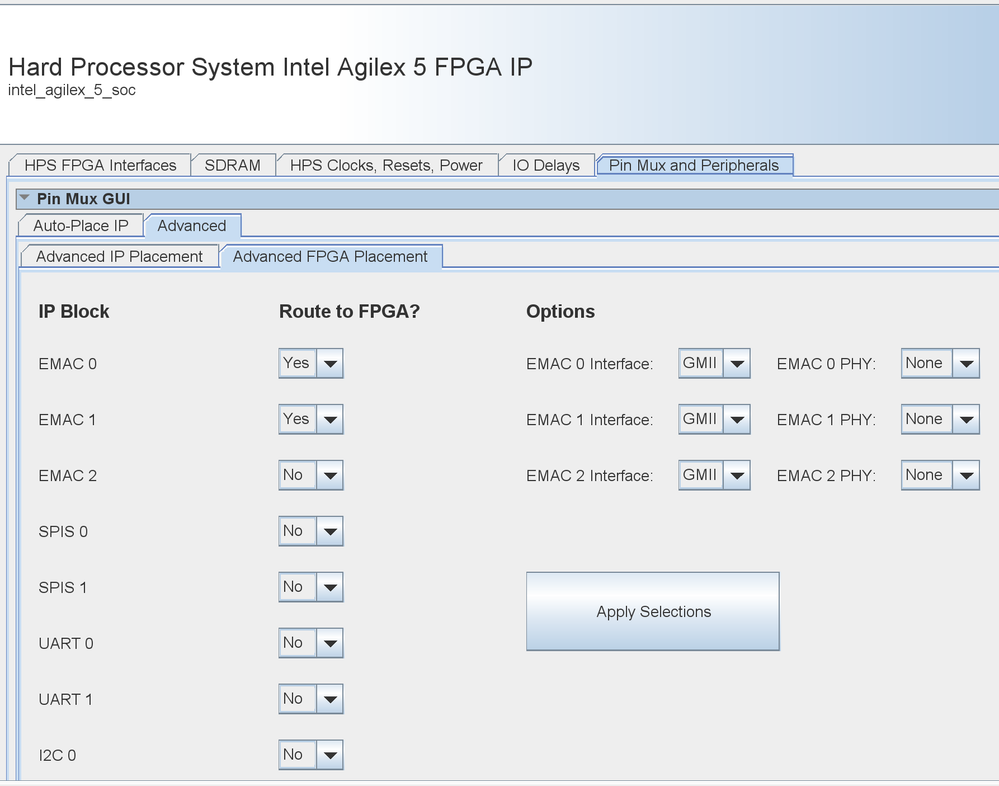

I am trying to instantiate EMAC's that can be accessed over the Fabric:
This builds successfully in the Qsys - however when adding it to the top level Verilog GHRD:

The compilation process exits at the fitting stage with the following issue:
Error(14566): The Fitter cannot place 1 periphery component(s) due to conflicts with existing constraints (1 NOC_FABRIC_ADAPTOR(s)). Fix the errors described in the submessages, and then rerun the Fitter. The Intel FPGA Knowledge Database may also contain articles with information on how to resolve this periphery placement failure. Review the errors and then visit the Knowledge Database at https://www.intel.com/content/www/us/en/support/programmable/kdb-filter.html and search for this specific error message number.
	Error(175001): The Fitter cannot place 1 NOC_FABRIC_ADAPTOR, which is within External Memory Interfaces for HPS Intel FPGA IP emif_hps_emif_hps_ph2_610_r3atsia.
		Error(16234): No legal location could be found out of 8 considered location(s).  Reasons why each location could not be used are summarized below:
			Error(175006): There is no routing connectivity between the NOC_FABRIC_ADAPTOR and destination HMC
				Error(175022): The NOC_FABRIC_ADAPTOR could not be placed in any location to satisfy its connectivity requirements
			Error(175006): There is no routing connectivity between the NOC_FABRIC_ADAPTOR and destination SOC_HPS
Error(15307): Cannot apply project assignments to the design due to illegal or conflicting assignments. Refer to the other messages for corrective action.
Error(16297): An error has occurred while trying to initialize the plan stage.
Any pointers on what I have done wrong would be greatly appreciated!
