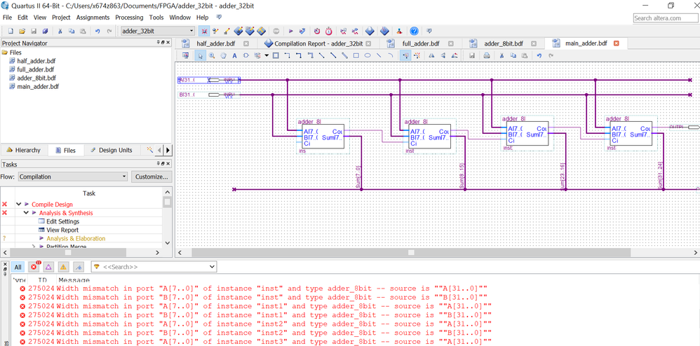

Width mismatch error
Hi there,
I am trying to add four 8-bit adder to create a 32-bit adder. As you can see, I am having issues as A[7..0] is going to A[31..0]. Same error for B input. However, I am not getting any error for Sum output (bottom line). How to fix this problem?
  • Hi,
    Same thing have to be done on A, B like the Sum. For the bus line from A[7..0] and B[7..0], have to Right-click -> properties -> Give name like A[7..0], A[15..8], A[23..16], A[31..24] for each inst. Same things goes for B.
    Sheng
    Sheng
