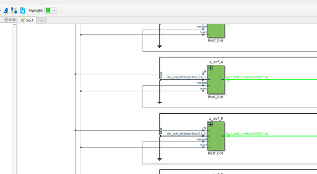

You have to find and highlight a path. You can search right in Chip Planner, but cross-probing is much easier. That's why I mentioned timing analyzer because that's the most common way of cross-probing a path into Chip Planner, but you can cross-probe from the RTL Viewer, the Technology Map Viewer, and others. Find the object or path, right-click, and select Locate -> Locate in Chip Planner. The "connectivity schematic" you mention is the resource property viewer/editor, which shows you how specific resources are used in your design (and you can make low-level changes to their use post-fit). When you select a particular resource in the device floorplan (or cross-probe a part of your design to the Chip Planner), this view shows that resource's details. Anything highlighted in blue is part of the resource that is being used by your design. Gray parts are unused.
What you've done here is located an individual resource instead of a path. Again, it's easiest to do what you want from the timing analyzer because you can select a path in a timing report and select Locate *path* in Chip Planner instead of just an individual resource like what you show in your screenshot.
1) When you refer to "bird's eye view", do you mean the little picture of the chip where you can click and drag the zoom box to pan around the chip? This is accessed with the toolbar button that looks like a little parrot. As for the Show physical routing command, as mentioned in the guide, this is accessed from the Locate History, which is used typically when you cross-probe from the timing analyzer to look at the physical details of a timing path. What are you wanting to do here?
2) Report Routing Utilization is a heat map view of routing congestion in the device. You can look for hot spots and then correlate with your design through cross-probing. "Fixing" hotspots is trickier because you don't need to fix them unless there is a problem, typically timing issues. Turning off Optimize Hold Timing is a common fix for reducing congestion, but, as the name implies, it can affect your hold timing numbers.
3) Show Physical Routing has been in the tool for ages. It works with all devices in Pro but not all in Standard (some of the older devices are left out, I think). Again, it's only accessible through the Locate History.

In Xilinx Floorplanner, users can easily gauge the floorplan for the Logic Lock Region connectivity, logic to IO connectivity, and logic to logic connectivity as the screenshot below:
Below is the floorplan view in the Chip Planner:
The connectivity schematic is available on the small window in the Chip Planner, but I don't know how to make the Chip Planner to show the connectivity on floorplan view. Here is my Layers Settings:
The reason to have the connectivity view available in the flooplan is for ease me to have a gauge on how far/close between logic to logic , or logic to IO without get that information from timing report by running Timing Analyzer.
May I know how can I acheive this in the Chip Planner? Thanks in advance.
- RKath43 years ago
I did according to your idea by cross-testing from a timing way in Timing Analyzer to the Chip Organizer, and presently I can see the network in that way, and it can show the different ways the web too.
