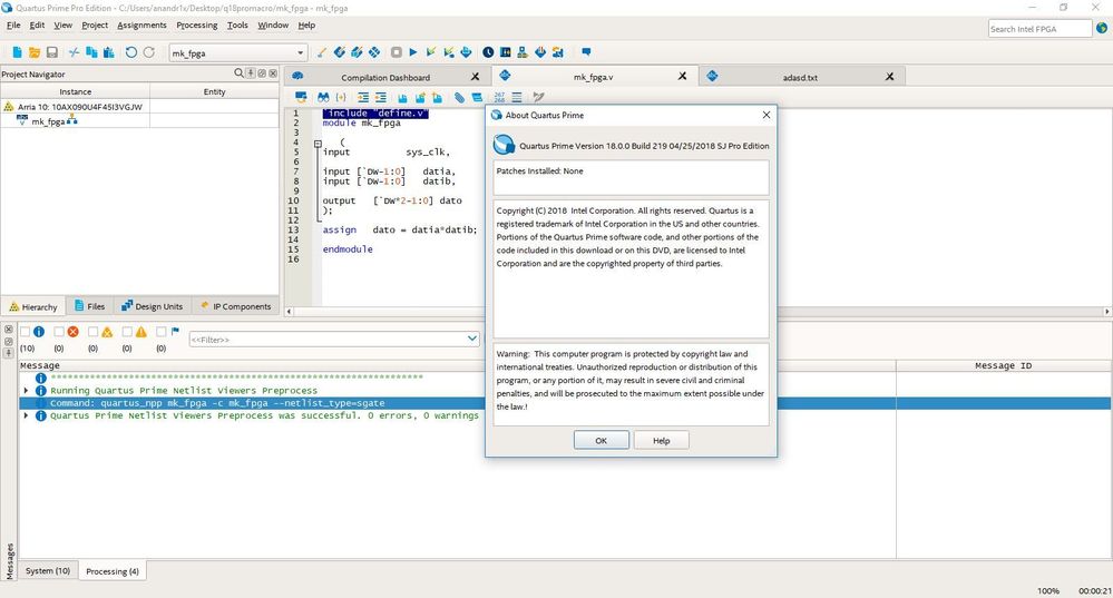

  • AnandRaj_S_Intel's avatar
    AnandRaj_S_Intel
    @Abe​
    @Kevin Hsing​
    IT'S NOT A BUG.
    If you would tried the link which i have shared, It would have solved your problem.( we verify answer before providing it).
    1. Quartus pro 18.0 works well with macros in separate file or in same file.
    2. I have verified with your design in quartus version(17.1,18,18.1) and edition(Lite & pro) & It read the defines file and take in the value, but you have to add `include "define.v" line in it design.
    Attached the documents with images.
    Anand
