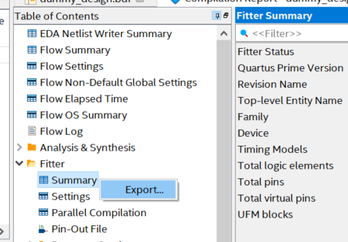

What is the script equivalent of Quartus Prime GUI's "Export Report as HTML"?
In Quartus you can export sections from the Report file as HTML.
How can you do the same when running Quartus from a script?
