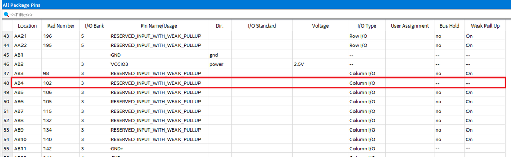

When compiling a Cyclone10 LP device, unused pins are set to “As input tri-stated with weak pull-up”.
Looking at the compiled report, the display is different only for unused VREFB pins.
Is Weak Pull Up enabled for this pin?

The pin number "AB4" enclosed in red is an unused VREFB pin. Is Weak Pull Up enabled?
- EngWei_O_Intel
What view is this in Quartus tools?
As far as I understand, you could set the unused pin as shown here:
whereas the Weak Pull-Up Resistor shall be set through pin planner or assignment editor:
Both are different setting.
