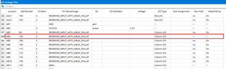

When compiling a Cyclone10 LP device, unused pins are set to “As input tri-stated with weak pull-up”.
Looking at the compiled report, the display is different only for unused VREFB pins.
I...
ken-salt
5 years agoThe pin number "AB4" enclosed in red is an unused VREFB pin. Is Weak Pull Up enabled?

What view is this in Quartus tools?
As far as I understand, you could set the unused pin as shown here:
whereas the Weak Pull-Up Resistor shall be set through pin planner or assignment editor:
Both are different setting.
